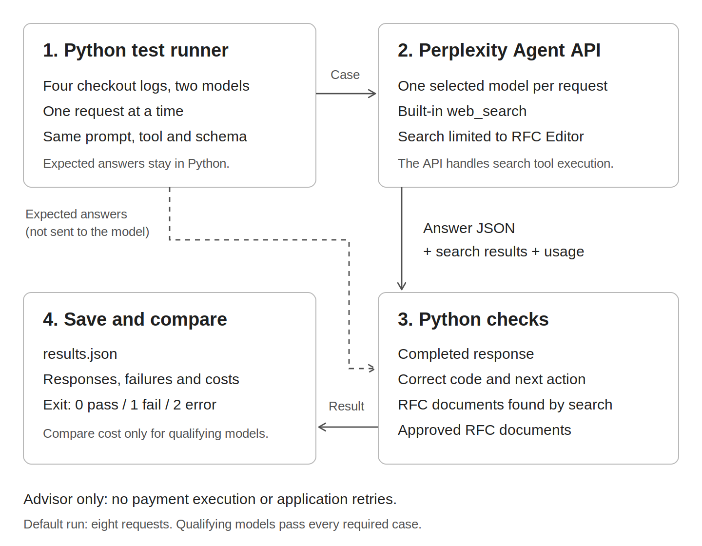

The Python runner sends four checkout logs to two models through separate Agent API requests. Built-in web search supplies RFC sources. Python checks the returned answers and citations against expected answers kept locally, then saves results and a pass, fail, or error exit code. The solid arrows show each request’s path through the test. The dashed arrow carries the expected answers directly to the Python checker, not to the model. Each case runs once per model by default, for eight requests total. The diagram shows one run. The optional comparison script reads two saved runs and identifies checks that changed from passing to failing.
One agent, two models, the same search tool
Perplexity gives you access to models from multiple providers through one API key and request interface (Multi-Provider Model Comparison). Its built-in web_search runs inside the Agent API request and returns source records you can inspect, with domain filters configured on the tool (Web Search).
  • Keep the application unchanged: Use the same instructions, search settings, and JSON output contract for both models.
  • Check sources and behavior: Require search results, the observed status and expected next action, and a citation to an approved RFC document returned during that run.
  • Compare cost after correctness: Read reported request cost from the response, then compare models that pass the checks. The Agent API exposes usage.cost.total_cost in its response (Agent API Models).

Define four decisions you cannot afford to change
Three checkout logs include an HTTP status. The fourth has none on purpose: your application did not receive a response, so the advisor must not invent a status or assume the payment failed. These are synthetic fixtures, not captured customer incidents. The action names are your application policy, not fields defined by HTTP. wait_then_retry means wait before retrying the read-only request; refresh_precondition means retrieve current state and reassess the conditional write; verify_outcome means establish what happened before considering another payment attempt. The script tests selection of these actions, not their execution or the exact wait duration. Each model receives the log and this shared policy, but not the case’s expected-answer record. The policy states the action and source rules on purpose: this is a small integration test of applying your contract, not a hidden-answer reasoning benchmark. Copying an observed status is easy; selecting the permitted action and preserving uncertainty are the behaviors you want to protect. The model must return code, next_action, and source_urls. The Agent API supports a JSON schema through response_format; the Python checker independently enforces the three-field contract, including rejection of extra fields (Output Control). For the payment case, the intended answer has this form. This is an illustrative expected answer, not a measured model response:
A test passes only when:
  1. The request completes.
  2. The response contains built-in search results.
  3. The returned status code and next action match the expected answers.
  4. Every cited RFC document appeared in that request’s search results.
  5. Every cited URL points to an approved RFC document, including the case’s required primary document.
The checker matches RFC document identity rather than exact URL spelling. It accepts the bare, .html, and .txt paths, an optional trailing slash, either RFC Editor hostname, port 443, and section fragments. It rejects other hosts, non-HTTPS URLs, credentials, other ports, query strings, and /info/ metadata pages. Two citations to the same RFC count as duplicates. This check establishes which document search returned, not whether the model read it or whether a cited section supports the answer. These fixed HTTP rules do not need live search in production; search is included here to test the Agent API’s retrieval-and-answer workflow. Add your own changing documentation and real failure cases before treating this as a production evaluation.
