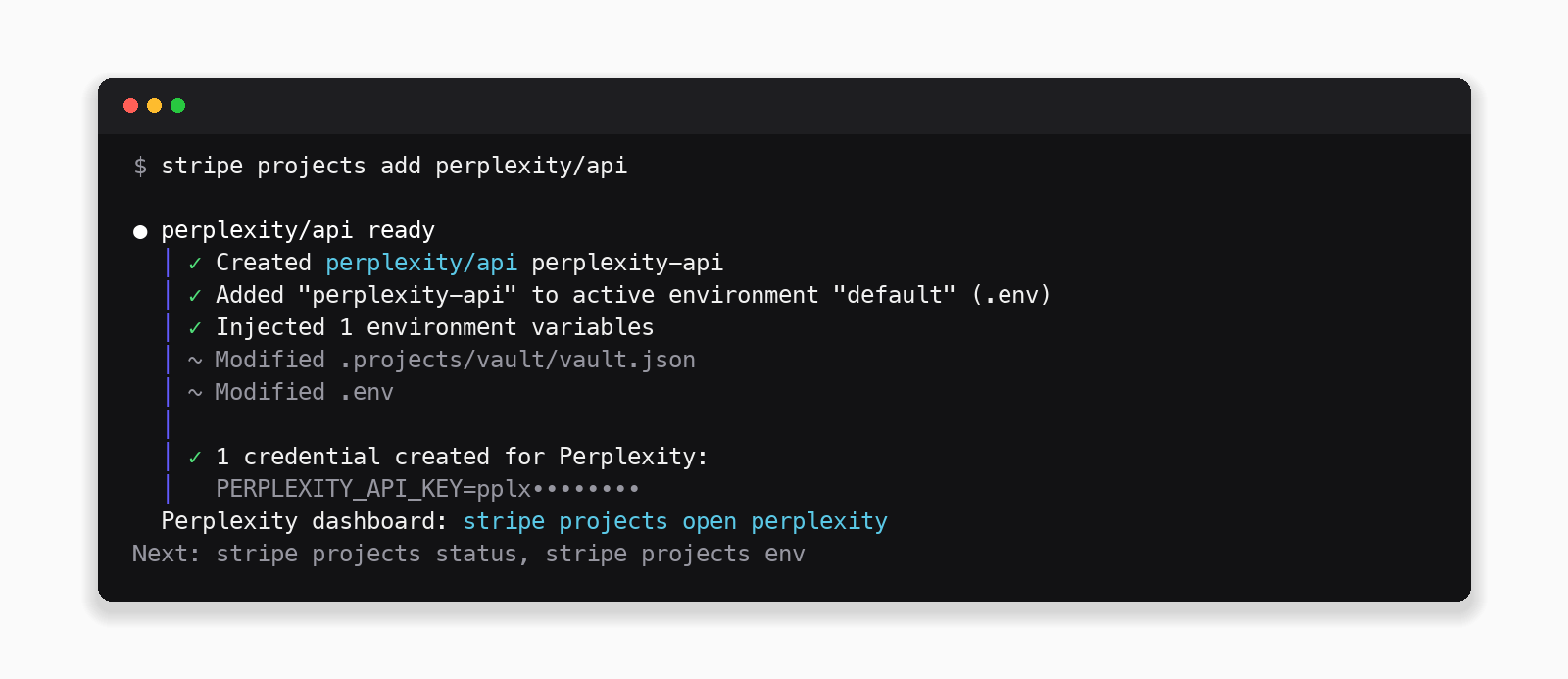

Add Perplexity
This creates a Perplexity API project, mints a key, and writes it to .env as PERPLEXITY_API_KEY:stripe projects add perplexity/api creating the Perplexity API project and writing PERPLEXITY_API_KEY to .envCreating a new Perplexity API project prompts for a $10 minimum credit purchase, charged to your Stripe account’s payment method. See Billing and credits for the full rules.

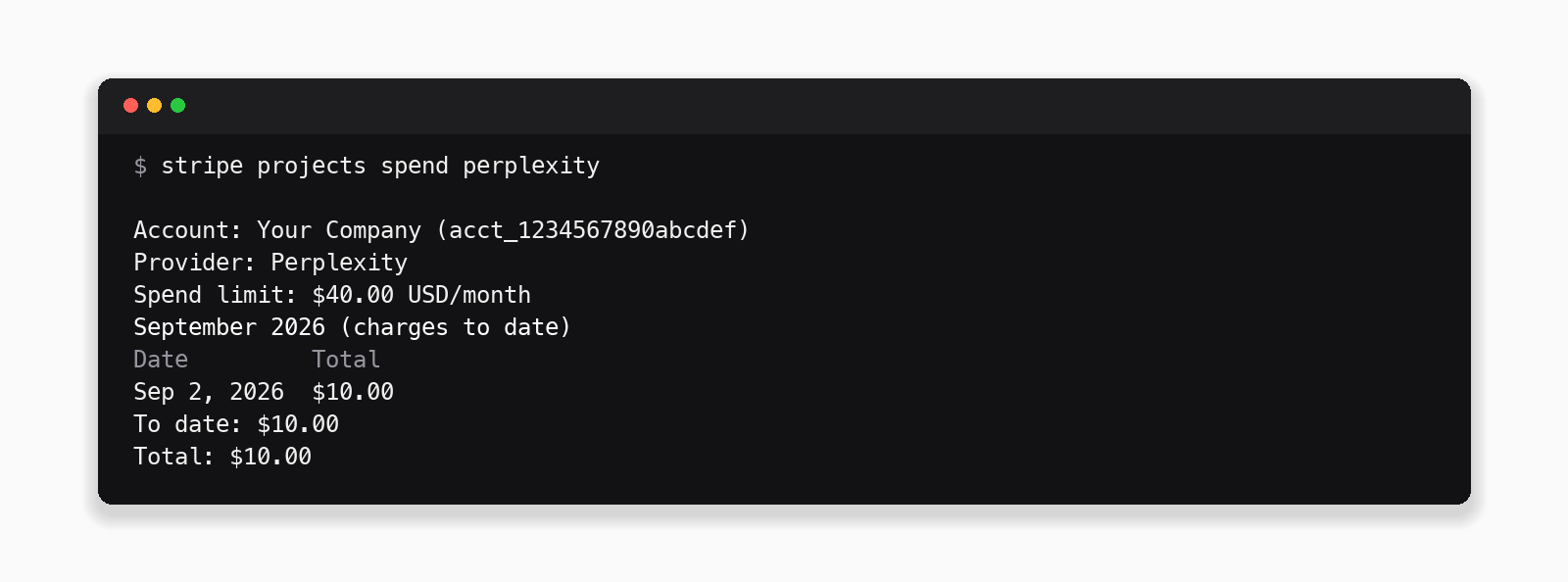

The CLI prompts for these when needed, and agents pass them with --config. The same settings are editable in the API Console, and changes from either place apply to the same Perplexity API project. Check spend
stripe projects spend perplexity showing the provider spend limit and monthly charges Stripe applies a monthly spending limit per provider. Adjust it with stripe projects billing update --limit 50 --provider perplexity. A purchase that would exceed the limit is declined; raise the limit and retry. If you run out of credits, the key is blocked until you add more. Enable auto_recharge ahead of time so credits are added automatically when the balance runs low.

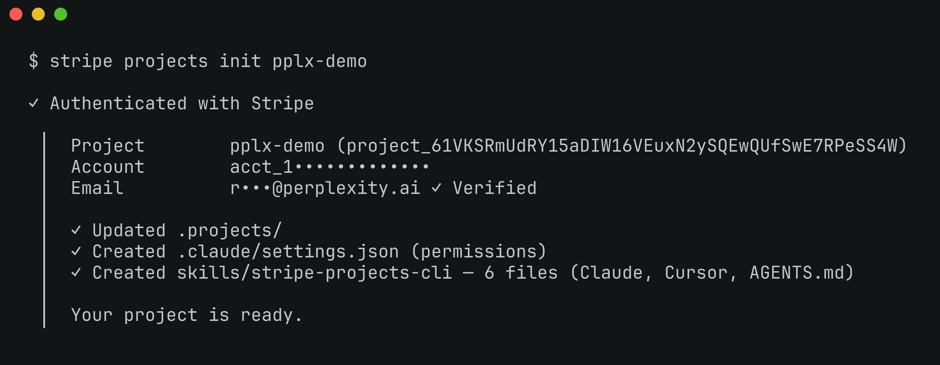

Install the agent skill
stripe projects init writes a skill into the Stripe project (Claude Code, Cursor, and AGENTS.md variants):stripe projects init creating the Stripe project and writing the stripe-projects-cli agent skill filesTo install the skill globally instead:
